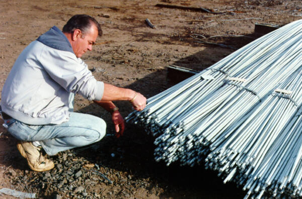

galvanized steel rebar inspection

Inspection of hot-dip galvanized steel is also simple because zinc will not react with unclean steel. Therefore, visual inspections are very accurate and easy to perform. Coating thickness is an important requirement as it directly relates to the effectiveness of hot-dip galvanizing as a corrosion protection system because zinc thickness is linear to the life of the coating. However, measuring coating thickness is only one of the requirements in the inspection process, other key items include adherence, appearance, and finish.
