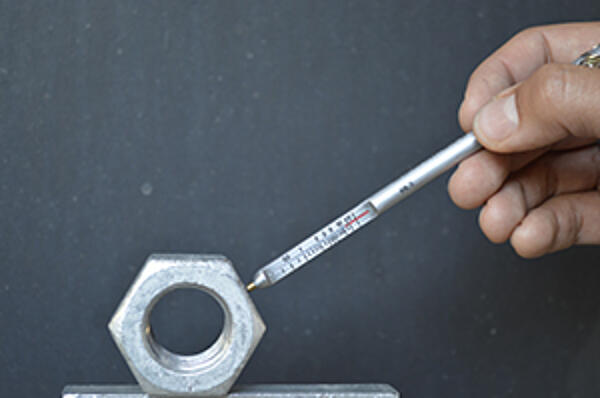

Pencil Gauge 09 Web
Pencil-Style Gauge

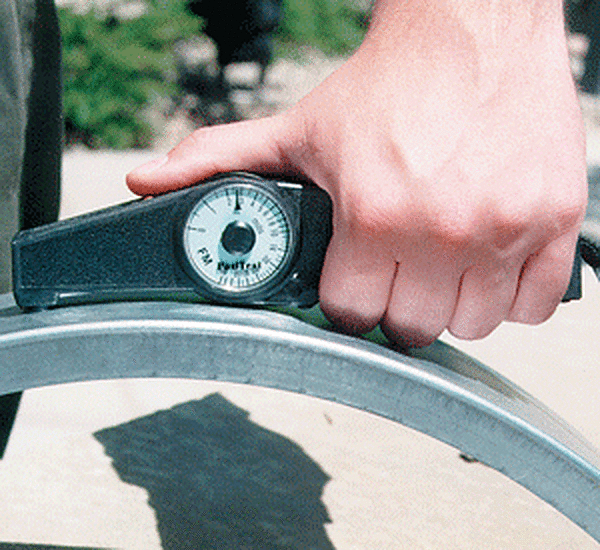

Banana Guage
  • Pencil-Style Gauge is pocket-size and employs a spring-loaded magnet encased in a pencil-like container.  Its accuracy depends on the skill of the inspector, thus the measurement should be taken multiple times.
  • Banana Gauges have an advantage over pencil-style gauges as they can measure the coating thickness in any position without recalibration or interference from gravity.

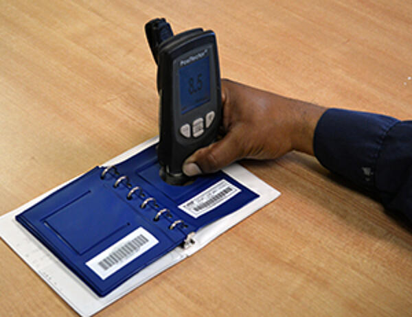

  • Electronic or Digital Gauge is the most accurate and easiest to use.  Furthermore, electronic gauges can store data and perform averaging calculations.
