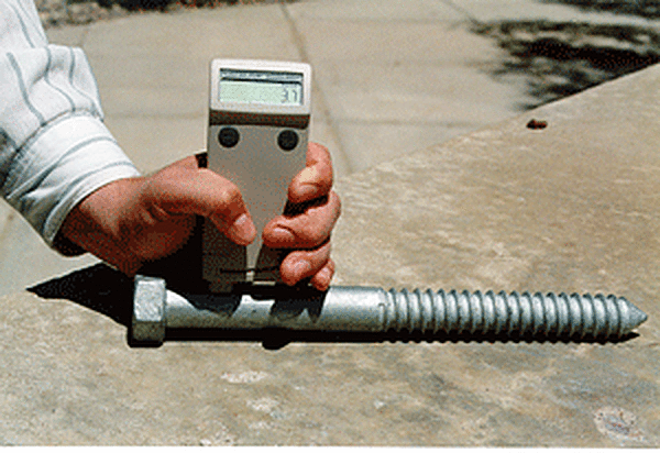

Electronic reading of galvanized steel thickness
A key feature of hot-dip galvanized (HDG) products is longevity and decades of maintenance-free performance. The time to first maintenance for galvanizing is directly proportional to the zinc coating thickness. Therefore, the coating thickness is the most important component in determining a galvanized coating's quality. However, the coating thickness is only one inspection criteria. Other key requirements include adherence, appearance, and finish.

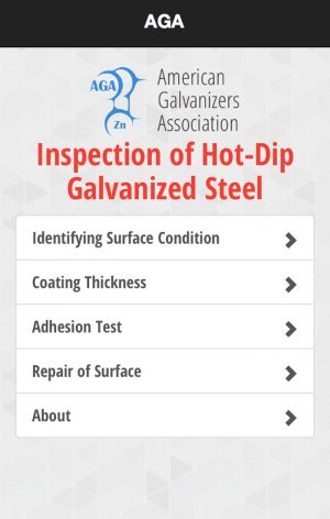

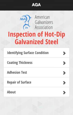

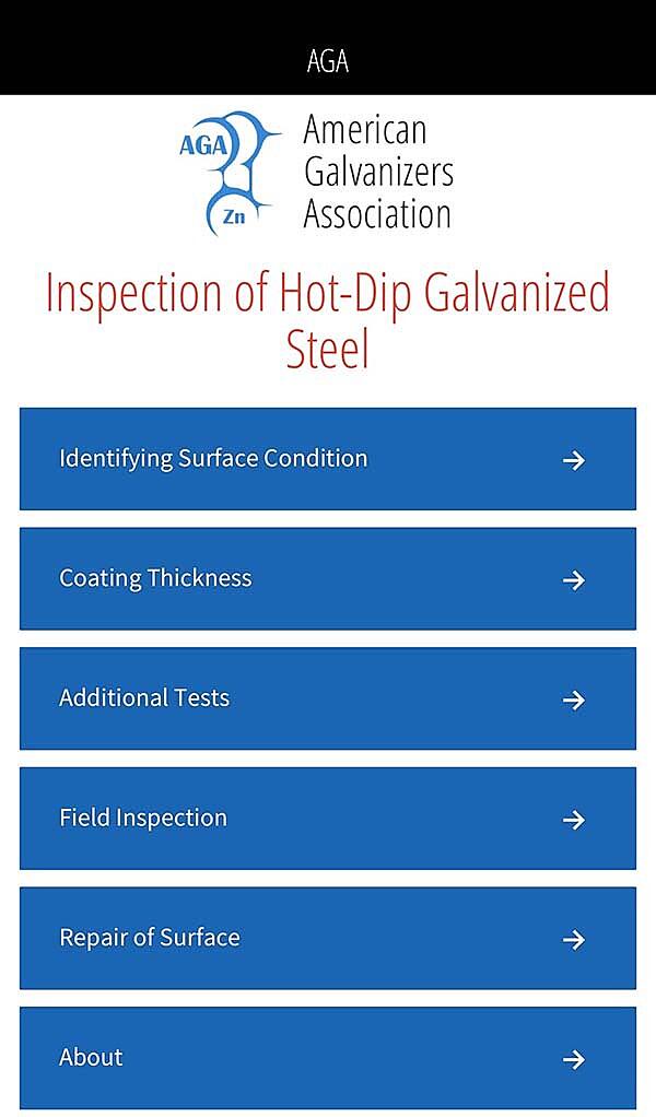

Inspection app screenshot
AGA Inspection of Galvanized Steel App
The AGA has created a comprehensive app to aid in the inspection of hot-dip galvanized steel. The app is a visual guide to identifying various surface conditions present after hot-dip galvanizing. Each image in the app is accompanied by text identifying the industry term for the surface appearance and detailing how and why it occurs, and whether or not it is accepted according to the specification. In addition to the visual interpretation of surface conditions, the app also contains critical specification (ASTM, ISO, AASHTO) information to assess compliance with coating thickness requirements as well as how to conduct repairs.
The app is available for free in both the Apple and Google Play stores. Once downloaded, the app will work offline without internet or phone service, perfect for any jobsite!
