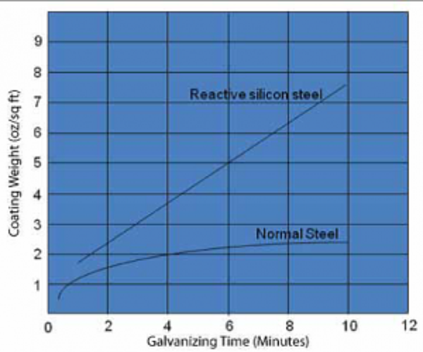

This question has come up with more frequency lately from galvanizers, possibly because reducing zinc consumption has become more important as belts have been tightened during the recession the last few years. The best place to start the conversation about achieving thinner coatings is by talking about steel chemistry since that has the biggest influence on coating thickness. For most types of non-reactive steel, which is steel that meets the chemistry recommendations listed in ASTM A385, you will not have to worry much about excessively thick galvanized coatings, because, after a few minutes in the galvanizing kettle, coating growth levels out (see Figure 1).
That is not the case with reactive steel, which is steel that falls in the Sandelin Range or has a silicon equivalent (see below) greater than about 0.25%. For these types of steels, coating growth continues as long as the steel is left in the kettle (see Figure 1).

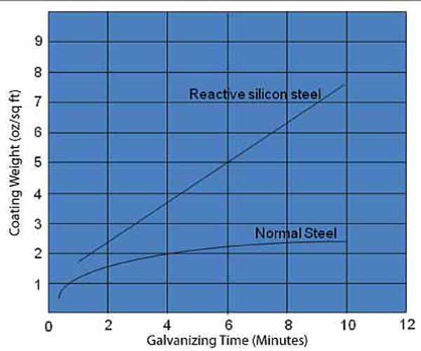

If you know your customers steel is reactive, sweep blasting it is the surest way galvanizers have to reduce excessively thick coatings. Blasting the steel roughens the surface, which causes the zinc crystals to grow into one another rather than growing vertically like on steel that has not been blasted. The thickness of the galvanized coating is reduced when the zinc crystals grow into one another. When you know you have reactive steel, another thing you can do is leave the steel in the kettle for a shorter period of time. This is not always possible, for instance, when galvanizing very thick steel which must be left in the kettle longer to achieve the necessary temperature for the metallurgical reaction to happen. Notice in Figures 1 and 2, coating growth is proportional to the time the steel is in the kettle. Another way to limit coating thickness is by reducing the kettle temperature. Higher temperatures help the galvanizing reaction to happen faster. The corollary is lower galvanizing temperatures tends to cause slower reactions, which can reduce coating thickness.
