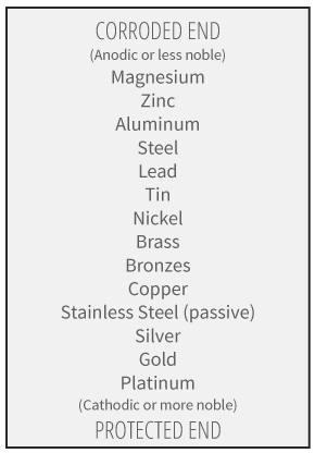

As in all design and fabrication situations, the problem is not as simple as just looking it up on a chart. The zinc has been applied to the steel to provide corrosion protection for the underlying base steel. If zinc is in contact on the surface with a more cathodic metal and the zinc becomes part of a bimetallic couple and corrodes, then the zinc is not performing its designed function of protecting the base steel. The formation of a bimetallic couple needs four elements in order to form. The existence of two dissimilar metals in direct contact can be no problem whatsoever if there is no electrolytic material present.
In most atmospheric applications the only potential electrolytic material that can be present is rainwater or dew. Both of these forms of water are poor electrolytic materials since they do not contain many salts and ions which would make them conductive. On the other hand, marine environments and areas where the melting snow includes road salts can be very good electrolyte materials. Bimetallic couples are more easily formed in immersion situations where the assembly will be underwater when it is in service. Salt water is especially tough on two dissimilar metals in contact. The best guide as to how various metals will react in contact with zinc under different environments is the following table.
The performance of zinc in contact with most of the common building metals is rated for most environments. This figure is easy to understand and provides a good reference sheet to fax to those who are concerned with the potential of forming a bimetallic cell.

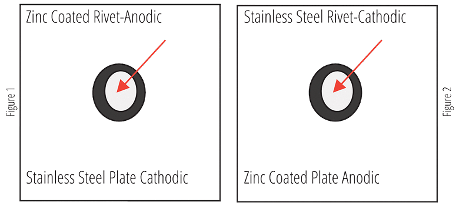

The rate of penetration of corrosion increases as the ratio of the cathode to anode surface area increases; as it decreases, the rate of penetration decreases. This situation is portrayed using a riveted fastener as shown in Figures 1 and 2. When using a stainless steel plate with a zinc rivet (Fig. 1), the ratio of the cathode surface area to the anode surface area is large, and the rivet will fail rapidly because of accelerated corrosion. When combining a zinc plate with a stainless steel rivet (Fig. 2), the area ratio between the cathode and anode is reversed, and although more surface area is affected, the depth of penetration is small; the fastener should not fail because of corrosion. The size correlation to the corrosion rate is also shown in Table 1.
Surface area of metal in row relative to Surface area in column | Zinc | Stainless Steel | |
Zinc | Small Large | -- -- | S G |
Stainless Steel | Small Large | G G | -- -- |
