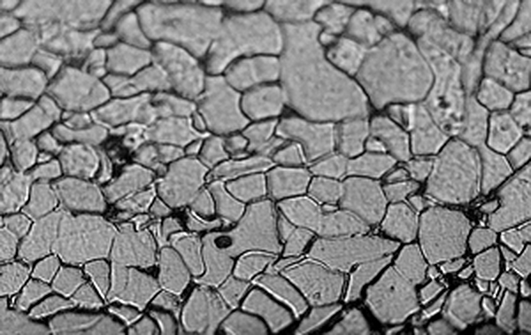

Micro1
Microstructure of steel after hot rolling
By Industrial Galvanizers Corporation Pty Ltd. The aim of this study was to determine if hot-dip galvanizing processes affect the yield strength of high strength steel. Uncoated (black) steel and pre-galvanized sheet steel were also tested. The pre-galvanized sheet was first pickled to remove the existing zinc coating and was then put through the normal galvanizing steps prior to being dipped into the kettle. The results of the tests for both the black steel and pre-galvanized sheet steel that had been pickled and then re-galvanized showed the difference between the nongalvanized steel and pre-galvanized sheet steel had a variation in yield strength of less than 1%, which was within the accuracy tolerance of the testing procedure. In other words, the tests conducted in this study found galvanizing did not affect the yield strength of either black steel or pre-galvanized sheet steel that had been stripped and then re-galvanized.

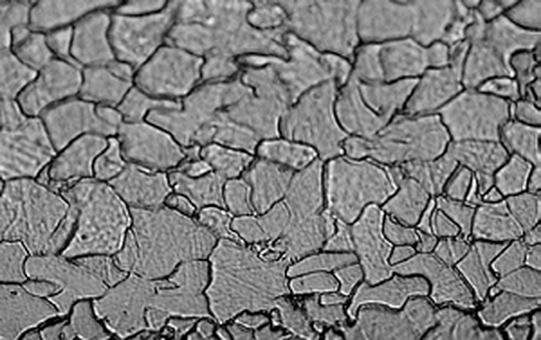

Micro2
Microstructure of steel after hot-dip galvanizing.
Fracture properties in this test included absorbed energy a notch toughness. Results of the tests showed measured differences between galvanized steel and steel that was not galvanized were very small and most likely attributable to microstructure heterogeneity. The overall conclusion was hot-dip galvanizing does not have any influence on fracture properties of steel. No differences were found in the microstructure of galvanized steel compared to steel that had not been galvanized.
