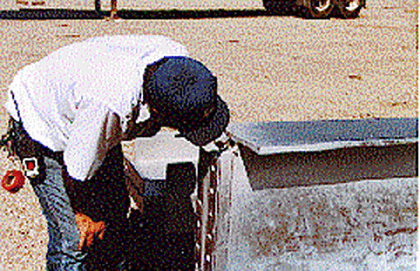

Magnetic gages measure either the magnetic attraction between a magnet and a magnetic material such as steel or measure the magnetic flux change through a coating to a magnetic steel substrate. The methodology for using this type of gage is contained in ASTM E376. Magnetic thickness gages have been studied a number of times The conclusions are very consistent that the gages are accurate to within 3 to 10 micrometers. More expensive gages are more accurate. These types of gages should be calibrated often to retain their accuracy and repeatability. Magnetic thickness gages are very accurate on flat surfaces but are inaccurate on curved surfaces. Surface roughness can also reduce the accuracy of the thickness readings.

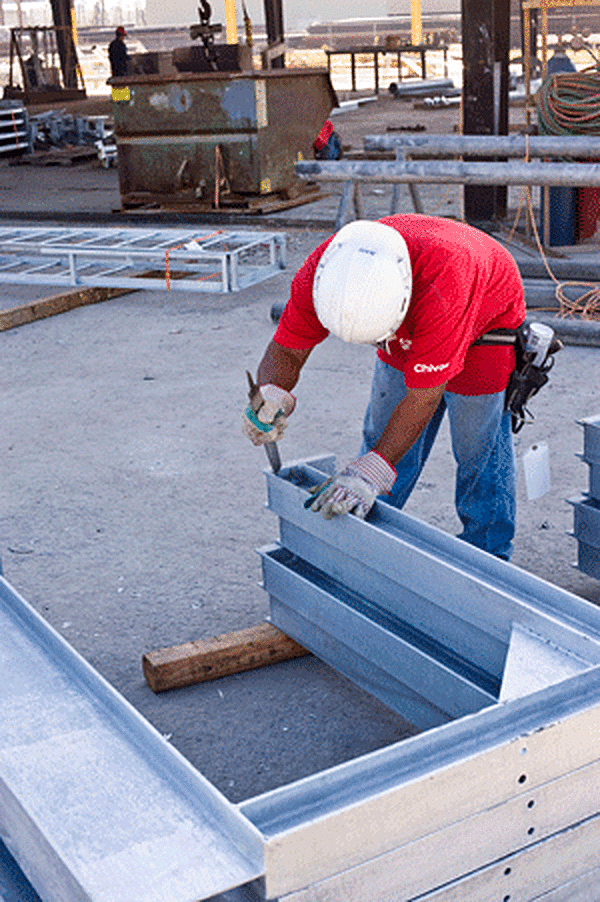

Sampling
Specification ASTM A123 calls for an average coating thickness to be a minimum of a specific value. The average is obtained in different ways depending on the size of the galvanized article. For small galvanized articles whose surface area is less than 1000 cm2, each individual piece shall be considered a test article and shall have no less than five measurements made of its coating thickness. The average of those five measurements shall be considered a specimen coating thickness and shall be not less than one coating grade below the required coating grade for the material. The average of the appropriate number of specimens shall be greater than the required coating grade for the material. So if there were 100 pieces of galvanized steel, a minimum of three pieces must be measured and their specimen coating thickness measurements must be averaged to determine the coating thickness for the lot.
For large galvanized articles whose surface area is greater than 1000 cm2, each individual piece shall be considered to be three sections for measurement purposes. Each section shall be treated as an individual specimen. In each section five widely separate measurements shall be taken to represent the overall coating thickness. This means that many measurements in a specific location do not represent the part's average coating thickness. The number of measurements may exceed five but may not be less than five in each section of the part. The average of these five or more measurements shall be treated as a specimen coating thickness value and shall not be less than one coating grade below the required coating grade for the material. The average of the three sections shall be considered the overall coating thickness and shall be greater than the required coating grade for the material.
For fabricated articles that have a mixture of different parts welded together to make a single fabricated structure, the coating thickness of each different type of material must be treated separately. for instance, a large sign structure may be comprised of different size tubing or pipe and have brackets or cross-bracing that is different thickness steel. All of the parts must be measured according to their material category and, if there are a number of brackets, all of the brackets must be treated as if they are tied together. The sampling procedures are intended to produce the most reasonable average coating thickness while still giving a statistically significant number of the coating thickness
