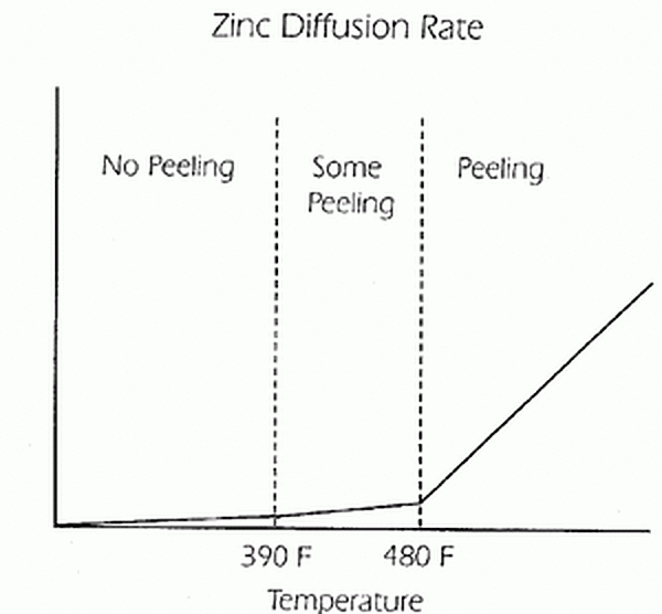

There are some concerns with using hot-dip galvanized steel in an elevated temperature environment. The industry has recommended the service temperature for conventional coatings to be less than 390 F (200 C). The concerns with operating above this high-temperature limit include peeling, some changes in mechanical properties, and a reduction in corrosion protection.
Peeling

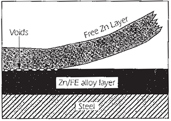

Peeling is caused by metallurgical changes that create a series of closely spaced voids at the free zinc-alloy interface. These voids are produced by a diffusion of zinc from the outer free zinc layer into the inner alloy layer. When these voids expand and form a gap, it causes the outer free zinc layer to split-off from the underlying zinc-iron alloy layers. This process is known as the Kirkendall Effect and is illustrated in Figure 1.
Tempg
Figure 2
However, the remaining zinc-iron alloy layers will still provide a high level of corrosion protection for many years, exactly how long depends on the coating thickness remaining. At temperatures ranging from 390 F (200 C) to 480 F (250 C), the zinc-iron alloy layers will continue to protect the steel from corrosion.
High temperatures above 480 F (250 C) will accelerate peeling and continued exposure can result in the zinc-iron alloy layers cracking and separating from the steel. Figure 2 shows the peeling of galvanized steel versus the temperature of the environment. This is also related to the zinc diffusion rate.
Apart from the predominant effect of the time/temperature conditions, the rate of the deterioration process is influenced by coating thickness, the relative thickness of outer zinc and iron-zinc alloy, and by the uniformity of the individual layers. By its effect on the length of the zinc diffusion path or the rate of the iron-zinc interdiffusion reaction, any of the coatings factors can affect the speed and degree of coatings deterioration. At or below the industry-recommended limiting service temperature of 390 F, the coating resists zinc layer peeling.
As discussed, peeling does occur at temperatures above 390 F and is dependent on the rise in temperature and the duration exposed. But this does not mean corrosion protection is lost. During peeling, only the outer free zinc layer has become detached, leaving the zinc-iron alloy layers to provide corrosion protection to the steel.
Kirk
Figure 1 The Kirkendall Effect
