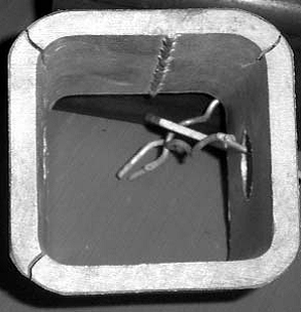

Hydrogen embrittlement, strain-age embrittlement, liquid-metal embrittlement, galvanizing embrittlement . . . sheesh! I think Im coming down with a case of brain embrittlement trying to determine what form of embrittlement has caused my steel tubes to crack. HELP!

Now on to the not-so-well-known embrittlements. Strain-age embrittlement refers to cracking caused by previously introduced stresses into the steel and is often the culprit in most embrittlement cases of HDG steel. Steel that has been cold-worked during fabrication develops certain areas of high stress. If these stresses are not relieved by heat treating prior to galvanizing, they can be partially relieved in the galvanizing kettle, which can often cause cracking if the stresses are relatively high. This can be eliminated by two separate methods. First, the steel can be heat treated at 1100°F for one hour per inch of steel section thickness prior to galvanizing, completely relieving the stresses caused by cold working and virtually eliminating the likelihood of cracking after galvanizing. The second method would be to not perform cold working but to hot work the part. By forming fabrications under heat, stresses do not develop in particular areas such as bend corners, punched holes, or other areas that are susceptible to developing high stress. With respect to your particular problem, this is the likely cause of the cracking. The tensile strength of tubes is far below that required for hydrogen embrittlement, as well as the forming operation required to fabricate the tube most likely involved the bending of a flat plate into a tube shape. This operation was probably performed while the steel was cold, and areas of high stress developed at the corners and initiated the cracking of the tube.
