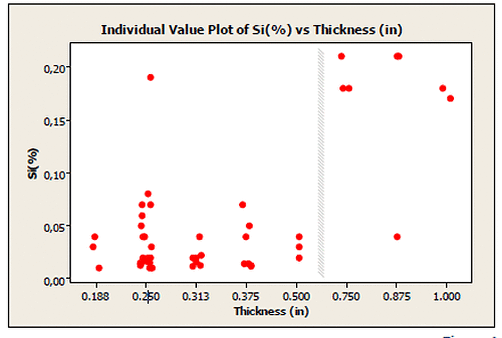

Why do aluminum-killed steels develop a thinner hot-dip galvanized coating than silicon killed-steels?

Silicon is added to iron during the steel making process and acts as a deoxidizer. It prevents oxygen in the air from reacting with carbon that is added to the iron. (Carbon is added to iron to strengthen the steel.) Another deoxidizer that is commonly used in the steel-making process is aluminum. Aluminum does not act as a catalyst in the galvanizing reaction like silicon does.A recent study conducted by Corbec Inc. looked at the difference in galvanized coating thicknesses on silicon and aluminum-killed steels. The study showed it can be difficult to meet the coating thickness requirements of various galvanizing specifications when aluminum-killed steels are galvanized. This problem is exacerbated when the galvanizing kettle has nickel (nickel can reduce the coating thickness on reactive steel with silicon levels less than 0.20%), which tends to develop excessively thick galvanized coatings.
This study by Corbec was critical to recent changes made to ASTM A123/A123M for the two different material categories, Structural Shapes and Plate and Strip and Bar, for steel thicknesses ranging from >3/16 inch to <1/4 inch. The changes reduced the minimum coating thickness requirements from 85 microns (3.4 mils) to 75 microns (3.0 mils). The need for the change in coating thickness requirements is demonstrated in Figure 1. This chart shows for plain carbon steel thinner than 1/2 inch, the silicon level tends to be low (often less than 0.05%). For these types of steels, aluminum is often used as the primary oxidizer. Because aluminum is the primary oxidizer in these steels, the silicon level will be low in these steels and the galvanized coating thickness tends to be thinner as well; so low in fact it is often difficult or impossible to meet the previous coating thickness requirement of 85 microns (3.4 mils).
In summary, aluminum like silicon acts as a deoxidizer in the steel making process. In the galvanizing process, the primary difference between these deoxidizers is aluminum does not act as a catalyst for the metallurgical reaction like silicon does. This means aluminum-killed steels tend to have thinner galvanized coatings than silicon-killed steels. For more information on this topic or studies on how silicon and aluminum affect the galvanized coating thickness, please contact the AGA Technical Department at [email protected]
