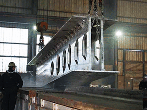

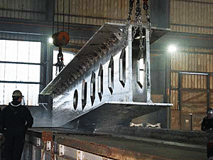

Hollow beam being galvanized
Providing lifting points is also important if aesthetics and coating finish are a high priority. Chain, wire and other holding devices used to support materials being galvanized can leave markings on the galvanized item, if special lifting supports or holes are not provided. These markings are usually completely galvanized; and thus not a reason for rejection of the coating. Uncoated areas due to material handling, removal of temporary lifting points, or chain marks can be touched up for aesthetic reasons, if desired.
In addition to lifting points, weight of the fabrication should also be considered. Because of the set up of the handling equipment and maximum load capacities, best practice is to consult the galvanizer if you plan to galvanize extremely heavy fabrications to ensure effective and efficient handling.
