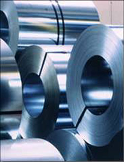

coils of continuous galvanized sheet metal
As the steel exits the furnace, it enters into a vacuum chamber, or snout, before entering the molten zinc bath to prevent any air from re-oxidizing the heated steel product. The steel is then sent around a submerged roll in the molten bath to create the bonded coating and removed in a vertical direction. As the product is withdrawn from the bath, precisely regulated, high-pressure air (air knife) is used to remove any excess zinc to create a closely controlled coating thickness. The steel is then allowed to cool and solidify before contacting another roll to avoid transferring or damaging the coating.
