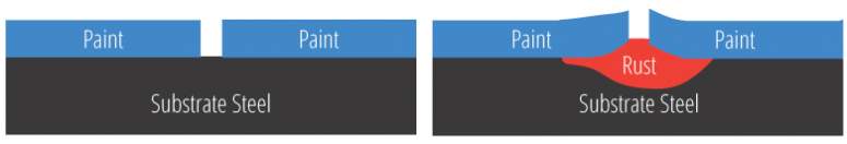

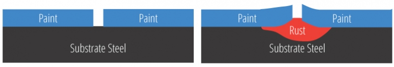

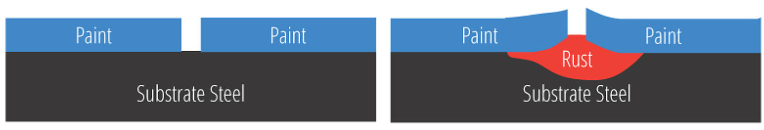

Paint can be applied to steel of any size or shape, though as mentioned, continuity of the paint systems is extremely important for carbon steel. Because of the application process (brush or spray) there will already be some inconsistencies in the coating thickness, particularly at corners and edges, and there is no coating or protection on the interior of hollow structures.  The graphic below shows how corrosion begins and progresses at a pinhole, scratch, or gap in the paint coating.
graphic representation of steel corrosion under paint coatings
When a paint barrier coating is breached (scratched, pinholes, etc.), the exposed steel corrodes and forms a pocket of rust. Because rust is much more voluminous than steel, the pocket swells and lifts the paint film from the metal surface to form a blister. Both the corrosion pit and the blister continue to grow.
