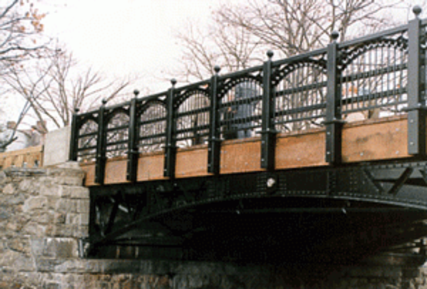

Thurston Ave Bridge Duplex Coated for Corrosion Protection

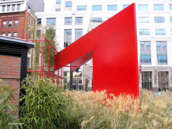

Chinatown Park duplex system

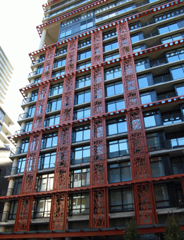

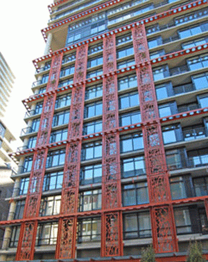

Woodward Building
Woodward Building

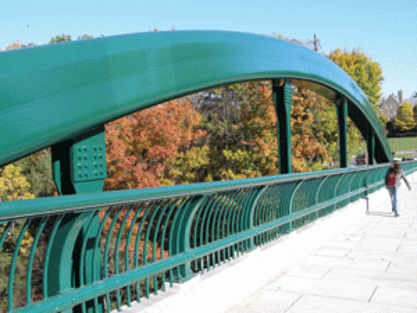

Duplex Painted Galvanized Steel Bridge
