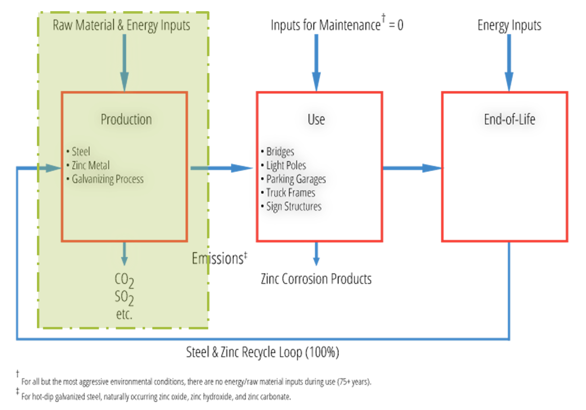

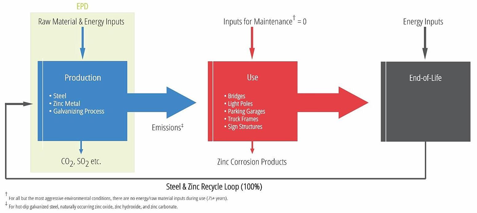

The cradle-to-gate study represented in the EPD is only part of hot-dip galvanized steels sustainability story. When evaluating hot-dip galvanizing on a full life-cycle (cradle-to-grave) basis, there are additional environmental benefits. The longevity of hot-dip galvanized steel means the raw material and energy inputs, as well as the emissions and waste outputs are isolated to the production phase, as there is no maintenance required for 70 years or more in most environments, and HDG is 100% recyclable at the end-of-life.
In 2008, the AGA developed a full life-cycle assessment (LCA) with thinkstep, Inc. (formerly PE International) which shows the environmental impact of hot-dip galvanized steel from the production phase to the end-of-life. The cradle-to-grave study is actually more of a cradle-to-cradle study, as both the zinc and steel of hot-dip galvanizing are 100% recyclable, essentially eliminating a grave for the product. The LCA took into account life-cycle inventories for structural steel, zinc, and the galvanizing process to fully understand the environmental impact of producing hot-dip galvanized steel, then added the use and end-of-life management.

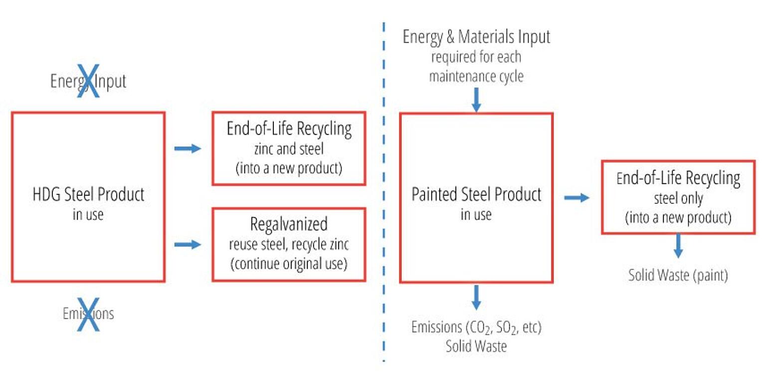

To fully understand the environmental impact of hot-dip galvanized steel, it is important to look beyond the production phase of the product to the use and end-of-life. Hot-dip galvanizing is unique because virtually all of the environmental impact is realized during production. In all but the most aggressive, corrosive environments, hot-dip galvanized steel provides 75 years or more of maintenance-free longevity, meaning during use, there is little or no environmental impact. On the other hand, paint and other corrosion protection systems often require a number of maintenance-cycles which each require energy and material inputs and create emission and waste outputs.

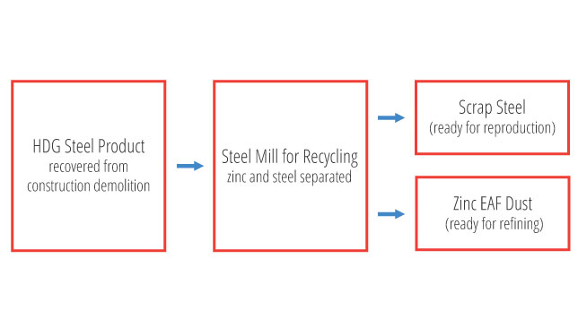

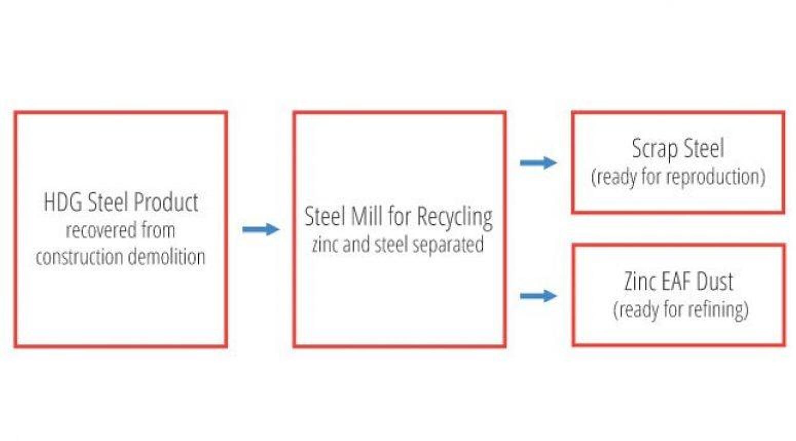

Furthermore, at the end-of-life, both the zinc and the steel of a hot-dip galvanized article are 100% recyclable and able to go back into the production phase to create more zinc and steel. For other coating systems, the coating would be blasted off creating waste, or burned off creating emissions, while only the steel would be salvaged. The recyclability of both the zinc and the steel result in a primary energy demand (PED) credit when considering the full cradle-to-grave (cradle-to-cradle) study.
So, overall the EPD data is very similar to the LCA data, so the data from the full cradle-to-cradle study is still relevant. This is important, because as mentioned before, only looking at the EPD or the environmental impact of producing a product/material does not give you the full story. To truly understand the sustainability of a material, you should look at the impact from raw material acquisition through end-of-life management.
