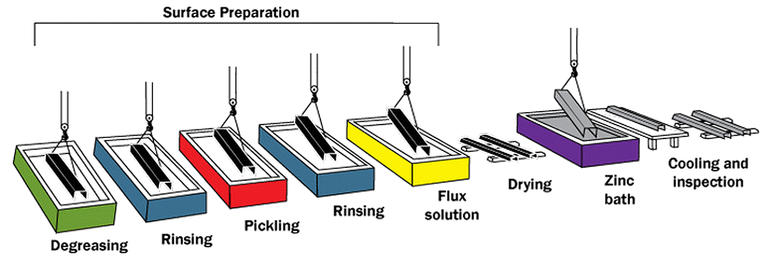

Hot-dip galvanizing is the process of coating fabricated steel by immersing it in a bath of molten zinc. There are three fundamental steps in the galvanizing process: surface preparation, galvanizing, and inspection. Lets review each in more detail.
Hot dip galvanizing process schematic 1550x526
Overview of the HDG process
Surface Preparation
When the fabricated steel arrives at the galvanizing facility, it is hung by wire or placed in a racking system which can be lifted and moved through the process by overhead cranes. The steel then goes through a series of three cleaning steps; degreasing, chemical cleaning, and fluxing. Degreasing removes dirt, oil, and organic residues, while the acidic chemical cleaning bath will remove mill scale and iron oxide. The final surface preparation step, fluxing, will remove any remaining oxides and coat the steel with a protective layer to prevent any further oxide formation prior to galvanizing. Proper surface preparation is critical, as zinc will not react with unclean steel.
Galvanizing
Galvanizing the steel, full immersion process
After surface preparation, the steel is dipped in the molten (830 F) bath of at least 98% zinc. The steel is lowered into the kettle at an angle that allows air to escape from tubular shapes or other pockets, and the zinc to flow into, over, and through the entire piece. While immersed in the kettle, the iron in the steel metallurgically reacts with the zinc to form a series of zinc-iron intermetallic layers and an outer layer of pure zinc.
