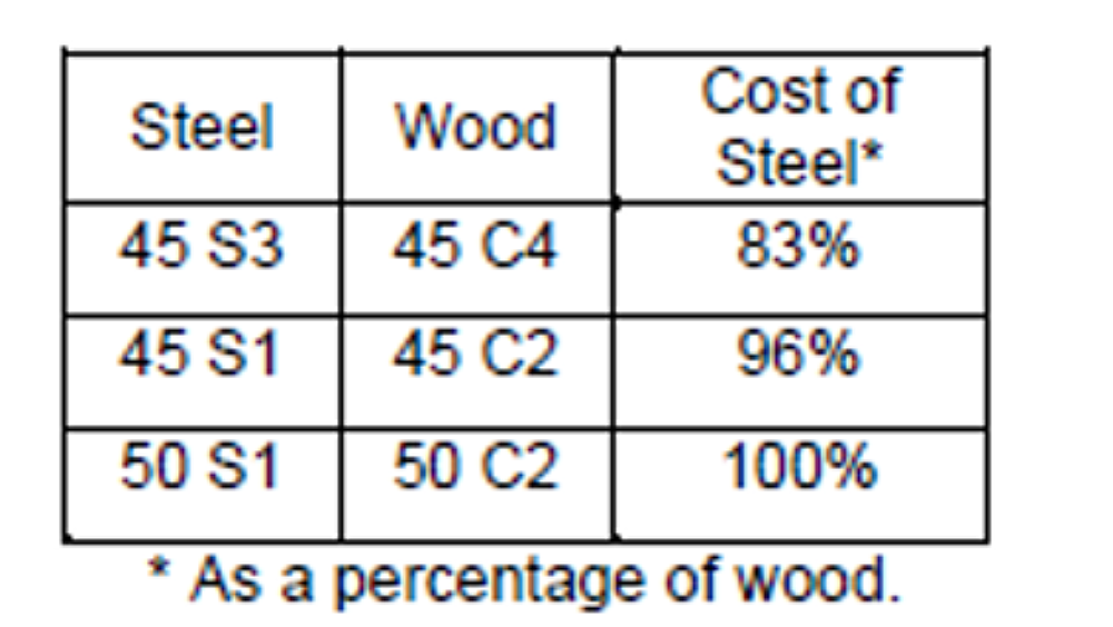

Tucson Electric, 2009
In addition to all the benefits using hot dip galvanizing has on reliability there can be substantial savings as well. In 2009 Tucson electric power set up a team to study several issues in depth to develop a clear understanding of how steel poles compare to wood. The team included employees from engineering, standards, construction, environmental, safety and purchasing. Out of this came a detailed life cycle cost analysis.
Tucson Electric
The table above compares the relative life cycle cost of steel vs. wood for three of the most commonly used sizes of distribution pole in TEP’s system. TEP found that even though the initial cost of a steel pole is much higher, a steel pole was actually cheaper or equivalent though its life cycle. This was due a steel pole lasting 60 years in TEP’s environment vs wood’s 30 years, Less maintenance throughout the pole's life, easier installation, and easy recycling at the end of life. TEP’s Senior Distribution Engineer, David Parpart added “the study also found that a steel pole offered better reliability in a consistent engineered product, while costing about the same”
