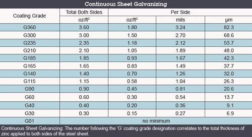

Each of these thicknesses, representing the same weight per unit area of zinc, would be expected to provide equivalent service life; i.e. 1.7 mils of hot-dip galvanized would give about the same service life as 2.2 mils of mechanical plating or 3 to 6 mils (depending on the paint formulation) of zinc-rich paint. It is also important to remember that for all continuous galvanized sheet materials, including electrogalvanized, the coating weight is given for the total zinc weight for both sides of the sheet. To obtain the amount of zinc per unit area of surface, the weight given must be divided in two, assuming equal distribution on both sides. For example, an ASTM A 653 Class G90 sheet contains 0.90 oz zinc/ft2 of zinc or about 0.45 oz/ft2 per side, as seen in the table below.

John Burkhart
What is the life span differance between G-60 galv and G-90 ?
(AGA)
Hi John, G90 has approximately 50% more coating thickness than the G60 coating thickness. Since coating life is directly related to coating thickness, this means a coating designation of G90 would last 50% longer than G60.
