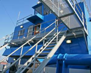

Dredge Edward S. Ned Reed

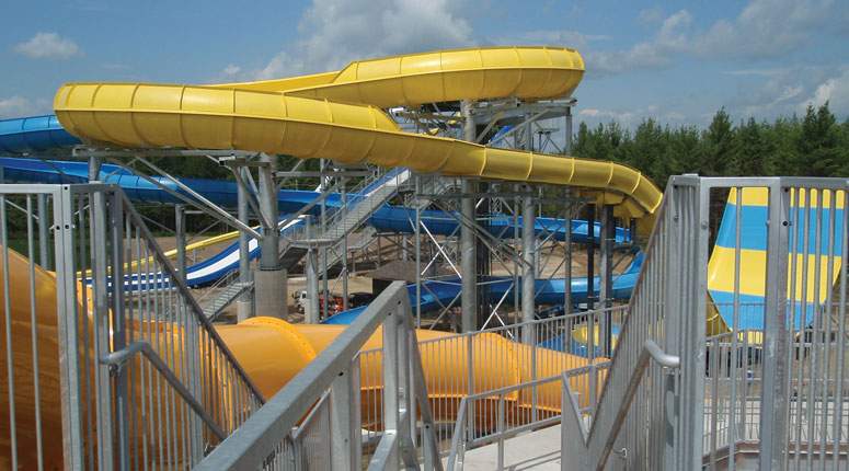

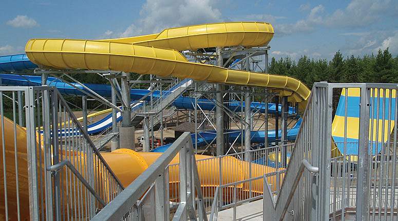

Calipso Water Park- Limonges, ON; 2009
Calipso Water Park
Branching upward like a metallic grove of trees across the grounds of the Calipso Water Park, the hot-dip galvanized support structures and stairwells allow visitors to the park to rest easy in the safety and stability of the parks slides and rides. In an environment constantly assaulted by the corrosive effects of water and chemicals, galvanized steel is the perfect solution to protect structural steel from damaging and unsafe corrosion. Galvanizing not only protects the steel from the point of view of structural integrity and safety, but also, it provides a long-term appearance free of visible rust spots.
