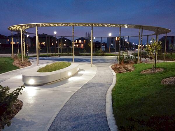

Place Alta Vista Pergola, Terrebonne, QC Canada
