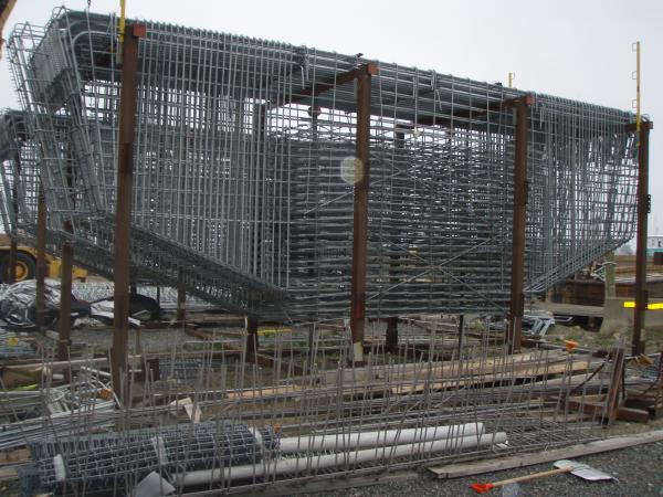

When galvanized steel is specified (see the AGA's publication, Suggested Specification for Hot-Dip Galvanizing Reinforcing Steel) the design requirements and installation procedures employed should be no less stringent than for structures where uncoated steel reinforcement is used. In addition, there are some special requirements to be observed when galvanized steel is used. The following suggestions are intended as a guide for designers, engineers, contractors, and inspectors. They are intended as a supplement to other codes and standards dealing with the design and fabrication of reinforced concrete structures and deal only with those special considerations that arise due to the use of galvanized steel.
The most important rule of designing for galvanizing is communication between the designer, fabricator, and galvanizer throughout the process. Communication with the galvanizer before the part is fabricated can help optimize turnaround times, minimize costs, and ensure a high-quality galvanized coating. This triad of communication can prevent the disappointment of unmet expectations.

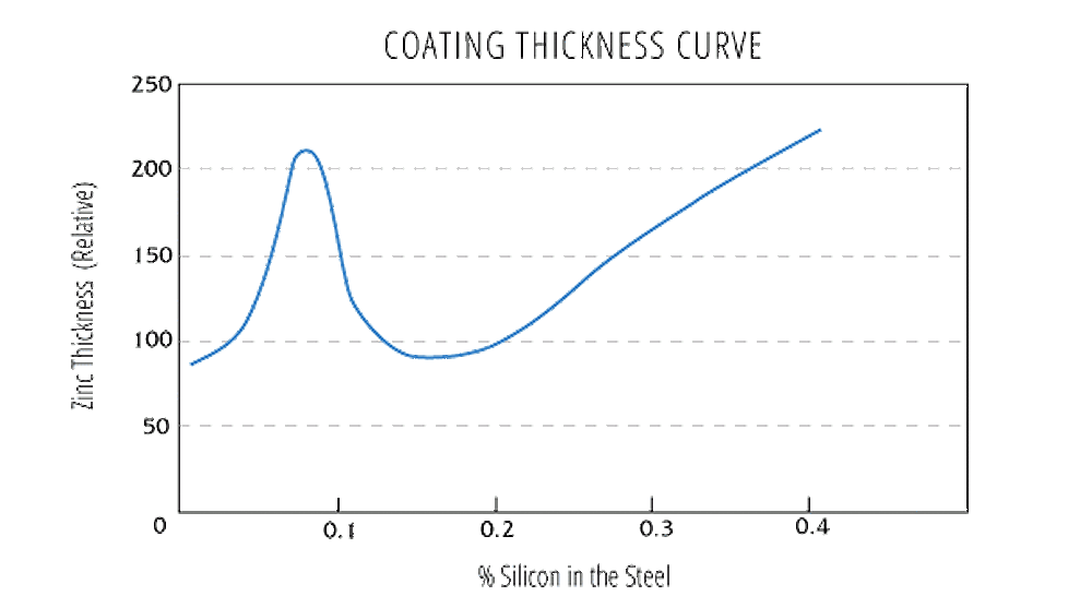

There are several factors that affect the zinc coating thickness, some which are manageable by the galvanizer and others that are not. The two readily manageable by the galvanizer are the temperature of the zinc bath and the withdrawal rate of the reinforcing bar from the zinc bath. To a lesser degree, the roughness of the surface affects the coating thickness. Therefore, parts that have been over-pickled and are rough on the surface can develop thicker zinc-iron layers. One condition, uncontrollable by the galvanizer, which significantly affects the outcome of the finished galvanized coating, is the steel chemistry namely silicon and phosphorous content. Certain levels of silicon and phosphorus tend to accelerate the growth of the zinc-iron alloy layers so the coating continues to grow the entire time the reinforcing steel is immersed in the zinc bath.
The Sandelin Curve of galvanized coating.

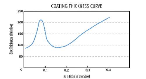

The Sandelin Curve shows the coating thickness produced by steels with different silicon levels immersed in the zinc bath for equal amounts of time. Following the Sandelin curve, there are two ranges of silicon content recommended for steels to be galvanized, below 0.04% OR between 0.15% and 0.22%, as detailed in ASTM A385, Practice for Providing High-Quality Zinc Coatings (Hot-Dip). Generally, steels with silicon content outside these ranges produce thick coatings characterized by a matte gray surface, indicating a predominately zinc-iron intermetallic coating with little or no free zinc outer layer.
Though service life is linear to the amount of zinc coating, hot-dip galvanized coatings more than 12 mils (305 microns) thick can be susceptible to damage from rough handling. These thick coatings may experience flaking of the outer free zinc layer in areas where external stress is put on the bars. In more extreme cases, the coating can fracture at the interface between separate zinc-iron intermetallic layers, leaving only a fraction of the original coating thickness.
One other factor affecting coating thickness is the blend of various bar sizes in a reinforcing steel assembly. Different size bars will develop zinc coating at different rates. The assembly must be kept in the zinc bath for a longer time in order to develop the minimum required thickness on thicker sections; therefore, smaller bars in the assembly tend to have thicker than normal coatings, which will be more pronounced if the silicon levels are outside the recommended ranges.

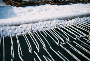

Different types of steel have different properties, including chemistry, strength, aging characteristics, etc., and these properties will influence the cold working properties of the steel. Because most black steel reinforcing bar is made primarily of scrap iron and has many different steel chemistries, different bend recommendations are necessary. This is because of the varying properties of the steel with varying chemistries. Hot-dip galvanized reinforcing steel can either be bent prior to galvanizing or after the galvanized coating has been applied.
Bending Before Galvanizing
When bending prior to galvanizing, it is recommended that the bend radii be as large as possible in order to avoid accelerated aging of the steel by cold working.  In the United States specification, ASTM A767, there is a table that gives guidelines for the recommended bend diameter based on the bar size. Hooks or bends should be smooth and not sharp. Cold-bending should be in accordance with the recommendations of CRSI. When bars are bent cold prior to galvanizing, they need to be fabricated to a bend diameter equal to or greater than those specified in Table 1. Material can be cold bent tighter than Table 1 values if it is stress-relieved at a temperature from 900 F to 1050 F (482 C566 C) for one hour per inch (2.5 cm) of bar diameter before hot-dip galvanizing.
Bending After Galvanizing
When bending after galvanizing, some cracking and flaking of the galvanized coating at the bend may occur. The speed at which the article is bent may also affect coating integrity. The galvanized coating is best maintained at slower bend speeds. According to ASTM A767, some cracking and flaking of the galvanized coating in the bend area is not cause for rejection. Any flaking or cracking can be repaired as described in ASTM A780, Practice for Repair of Damaged and Uncoated Areas of Hot-Dip Galvanized Coatings.
