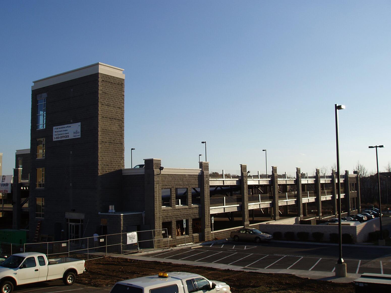

Durant Choctaw Garage
A steel core structure allows the designer more flexibility to adapt the structure to the site. By using techniques such as welding, bolting and splicing of existing columns, a steel framing system is easily adaptable to non-rectangular configurations that can be difficult to address with cast-in-place or precast concrete framing systems. With fewer, lighter pieces required and assembly techniques that can solve problems onsite, steel gives the designer more flexibility to negotiate problem areas and develop efficient solutions to challenging locations.

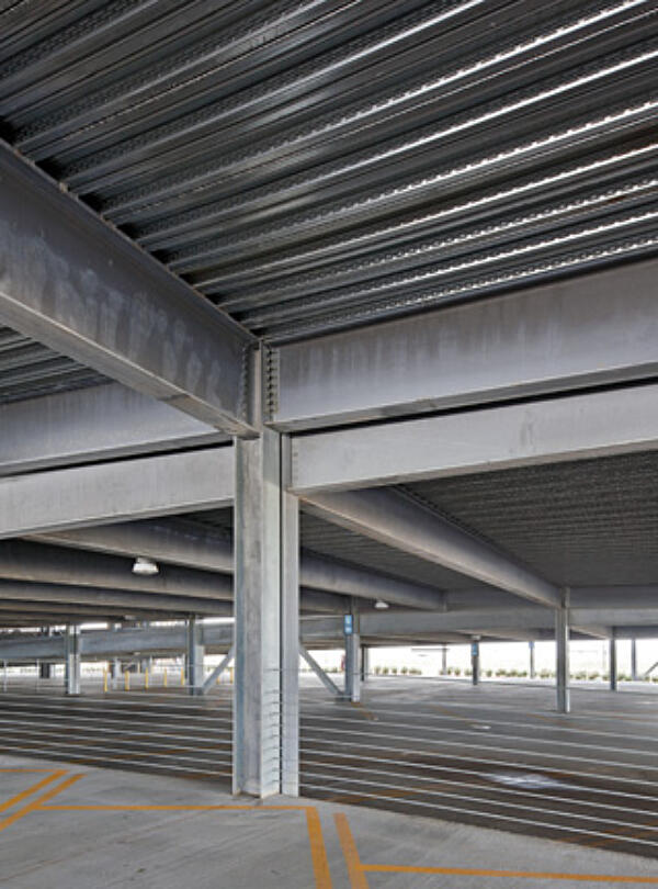

More Parking Spaces
The interior layout of the structure can also take advantage of the lightweight flexibility of exposed hot-dip galvanized steel beams. With slender beams carrying the weight of the garage on fewer, narrower columns, the designer will be able to fit more parking spaces into the same ground footprint. Steel columns require 80% less floor space than equivalent concrete columns1, increasing the usable floor area of the garage and decreasing the average cost-per-space of the design.

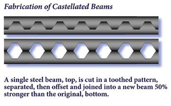

More Strength, Less Material
More strength, less material
Figure 4: More strength, less material
In addition to utilizing traditional steel members, one of the most efficient ways to capitalize on materials and space is by working with castellated beams. As seen in Figure 4, one steel beam is cut in either a toothed or circular pattern lengthwise, separated, offset, then rejoined into one cohesive piece.
The resulting beam is not only lighter but also 50% stronger than the original beam, maximizing the potential of a single piece of steel. Generally, the weight savings when castellated beams are utilized in a complete structure is 20 - 50%.2
There are many implications for such a weight-bearing, lightweight structural element. The increased strength of the castellated supports will allow for the possibility of more vertical stories and greater weight capacity per floor - meaning greater vehicle capacity for the garage.
