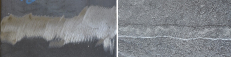

When the selected welding rod material is more reactive than the surrounding steel, a different appearance over the weld can be expected which is often duller in appearance, rougher, and thicker. Where unsure of base metal chemistry, the welding materials listed in Table 1 below can be used to generally reduce coating thickness over the welds, resulting in a more uniform appearance overall.
TABLE 1: RECOMMENDED WELDING MATERIALS FOR MINIMAL THICKNESS OVER WELDED AREAS (UPDATED 2017)
Welding Process | Lincoln Electric Welding Electrode | AWS Designation | Silicon (Weight %) |
SMAW | Jetweld 2 Fleetwood 35 LS | E6027 E6011 | 0.22-0.26% 0.10-0.18% |
SAW | L60-860 | F6A2-EL12 | 0.24% |
FCAW | *NR-203 NiC+ NR 203 MP NR 233 NR 311 | E71T8-K2 E71T-8J E71T-8 E70T-7 | 0.06% 0.22-0.26% 0.19-0.20% 0.12-013% |
*Note: It is recommend to use a test plate before use.
