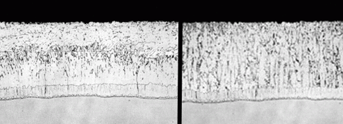

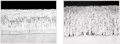

The amount of silicon added during the steel making process to deoxidize the steel can create differences in appearance of galvanized products. The recommended silicon composition for steel to be galvanized is either less than 0.04% or between 0.15% and 0.25%. Any steels not within these ranges are considered reactive steels and are expected to form thicker than average zinc coatings.
In addition to producing thicker coatings, highly reactive steels tend to have a matte gray or mottled appearance instead of the typical bright coating. This difference in appearance is a result of the rapid zinc-iron intermetallic growth that consumes all of the bright, pure zinc. This growth of the intermetallic layer is generally out of the galvanizer’s control, because they usually do not have prior knowledge of the steel’s composition. However, this increased coating thickness can be beneficial in some respects because time to first maintenance is directly proportional to coating thickness.
Figure 18 shows the difference in alloy formation on steel with the recommended silicon ranges (left) and those of reactive steels (right).  The photomicrograph clearly shows the microscopic level differences that can occur due to the amount of silicon in the steel being hot-dip galvanized.
Figure 18: Regular vs. Irregular Zinc-Iron Alloy Layers

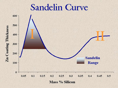

The Sandelin curve, as seen in Figure 19, compares the zinc coating thickness to the mass percentage of silicon in the steel. The area on the graph labeled “I” is called the Sandelin range, named after the metallurgist who discovered the behavior, and the coatings tend to be thick and dull gray as a direct result of the percentage of silicon present in the base steel. The Sandelin area is roughly between 0.05% and 0.15% silicon. The area on the graph labeled “II”, which represents a steel content of greater than 0.25% silicon, shows the coating thickness increases with increased silicon content and then starts to level off at around 0.4% silicon.
Figure 19: Sandelin Curve

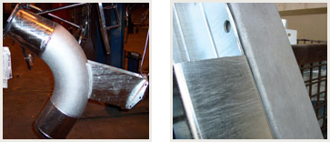

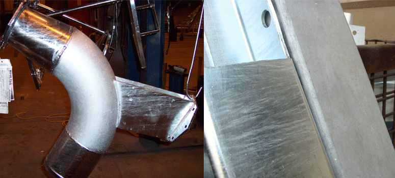

Figure 21 is an example of products with separate galvanized pieces that have very different appearances due to the difference in steel chemistry. This is often observed when connecting different types or thicknesses of steel, but can also occur on similar pieces.  Another common place this is found is in welded areas, as the silicon content of the weld rod can influence appearance.  Regardless of the appearance, all of these products have an equal amount of corrosion resistance and meet the specification requirements.
Figure 21: Shiny vs. Dull
