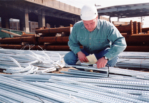

The inspection of finish and appearance is done with an unmagnified visual inspection. This inspection is performed by fully observing all parts and pieces of a hot-dip galvanized product to ensure all necessary components and specifications have been met. The purpose of the visual inspection is to identify any surface conditions, both inside and out, and check all contact points, as well as welds, junctions, and bend areas. The visual inspection should be completed at the galvanizing facility before the part is shipped.
