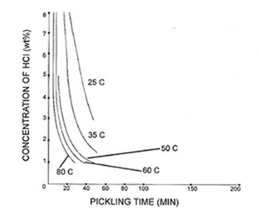

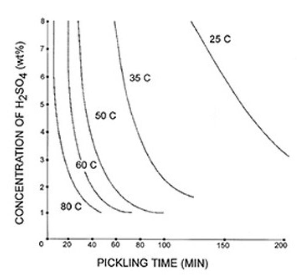

The rate of steel pickling is affected by the type of acid used, acid concentration, temperature, inhibitor concentration, and agitation. Figure 1 and Figure 2  give examples of possible pickling times based on acid type, concentration, and temperature. The graphs show the time it takes to pickle steel decreases with elevated temperatures in both types of acids. The pickling time in hydrochloric acid is shown to be much faster at 25C but is longer than sulfuric acid at elevated temperatures. The pickling time is also clearly shown to decrease as the concentration of the acid increases. However, the rate of pickling will asymptotically reach a limit as concentration increases. There are other factors that affect the rate of pickling. For information on inhibitors, agitation, and rinsing, please see the American Galvanizers Associations Galvanizing Note Pickling Iron and Steel.
Pickling2
Figure 1: Effect of hydrochloric acid concentration on pickling time

Figure 2: Effect of sulfuric acid concentration on pickling time

The text says that there are figures showing pickling rates but I cannot see the figures. Is there a permission issue or are the figures somehow lost in space? Thanks!
(AGA)
This is fixed!
