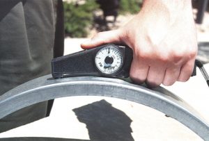

Black Banana Gauge
Regarding the minimum average thickness requirements, differences between the standards may be considered negligible and Galvanizers will most likely meet the requirements of ISO 1461 if they galvanized to A123. The table below helps point out these subtle differences. The table assumes steel is being galvanized according to the thicknesses in the left-hand column. This column uses the standard units of mm found in ISO 1461 but can be converted to imperial units. The table then gives the requirements of ISO 1461, and the thickness of steels whose A123 requirements overlap. Notice the ASTM requirements for coating thickness on wire never meet the ISO standards.
