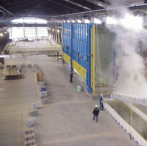

Dr Galv Aztec  Crowley  Plant
Aztec Crowley Plant
